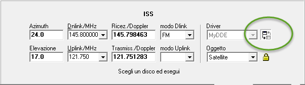

you need to configure MyDDE for use with IC7000BKT:
[Image: MyDDE.png]
1. Run MyDDE
2. Right click on the MyDDE icon in the system tray and choose Start (automatically starts IC7000BKT)
3. Run Orbitron
4. Connect Orbitron to MyDDE:
[Image: Orbitron.png]
