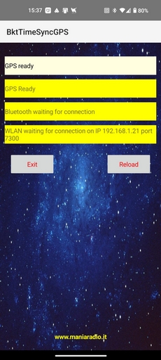

How to Use (Synchronization Procedure):
Start the App on the Smartphone: Open the BktTimeSyncGPS application on the Android smartphone. Ensure it is waiting for Bluetooth and/or WLAN reception.
Configure BktTimeSync on the PC:
Start BktTimeSync on the PC that needs to receive the data.
Find the section dedicated to connecting with BktTimeSyncGPS.
Enable reception: Check the checkbox labeled "Enable" (or similar) within the "BktTimeSyncGPS" group.
Choose and Configure the Connection Mode on the PC:
If choosing Bluetooth mode:
▪ Ensure the smartphone and PC have already been paired via Bluetooth.
▪ In the PC software, select the "Bluetooth" mode.
▪ From the appropriate dropdown menu (or device list), select the name of the smartphone running BktTimeSyncGPS.
If choosing WLAN mode:
▪ Ensure the smartphone and PC are connected to the same Wi-Fi network.
▪ In the PC software, select the "WLAN" mode.
▪ Open the BktTimeSyncGPS app on the smartphone and note the IP address displayed in the WLAN section (e.g., "WLAN IP Address: 192.168.1.XXX").
▪ Enter this IP address into the corresponding field within the PC software.
Start Synchronization: Once the connection is configured on the PC, the software should start receiving GPS data from the smartphone and proceed with time synchronization.
