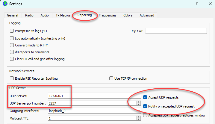

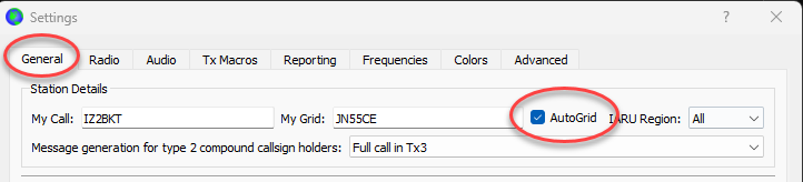

To enable AutoGrid, which sends a temporary locator to WSJT-X, set the parameters highlighted in the figures within WSJT-X.

- It only works if you use GPS synchronization.
- The WW Locator is sent to WSJT-X when BktTimeSync synchronizes the time using GPS or by pressing the [Send WW Locator] button.
- The sending of the WW Locator may fail if there are other software programs using the connection with WSJT-X. In case of an error, BktTimeSync will automatically retry for one minute.
