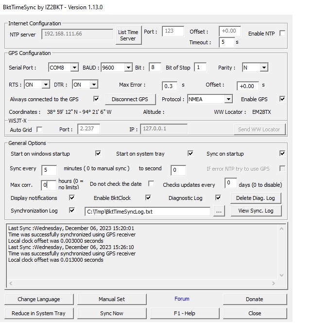

I have attached the developed settings I use for BktTimeSync:
[attachment=41]
The configuration has proven unreliable and I suggested to the PC user to reboot the Windows 10 PC on Friday of each week before leaving the office.

And last, please check the settings in the image I posted and comment if any of my settings seem unusual or counter productive.
Steve
The configuration is OK.

I have downloaded 1.13.0 and installed it. The installation/upgrade went smoother then I'd hoped. I simply disabled the log check marks and exited the 1.11.3 version then ran the 1.13.0 install file with run as administrator. The 1.13.0 version finished the install and started up. I re-enabled the log check marks,  left the interval at five minutes, set max correction to 0 and unchecked the Do not check the date. I rebooted The Windows 10 PC to make sure that BktTimesync starts automatically and it did. I'll check the logs again tomorrow to see the result and switch to every 60 minutes.
[attachment=43]
Thank you for a great program!

iz2bkt Wrote:Hello Steve,
the issue has been resolved in version 1.13.0.
I also recommend unchecking the box [Do not check the date].
Looks good with 1.13.0:
