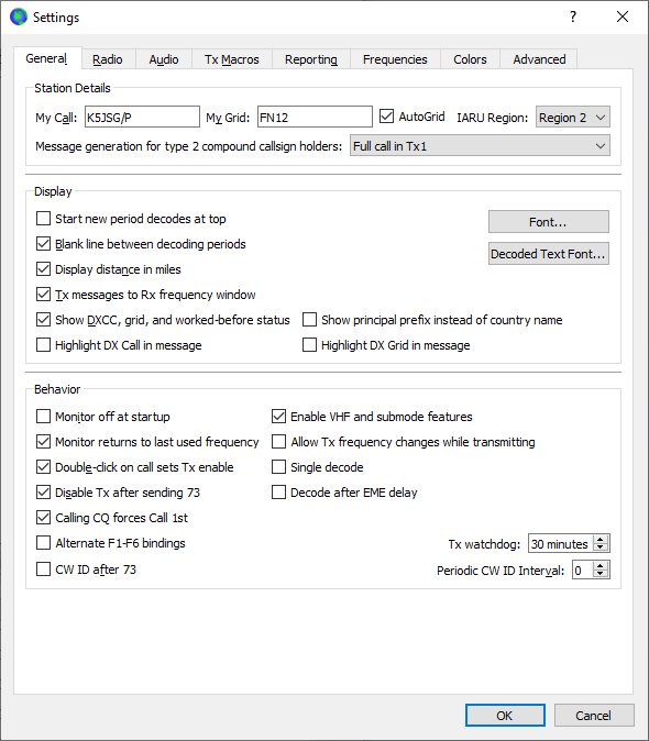

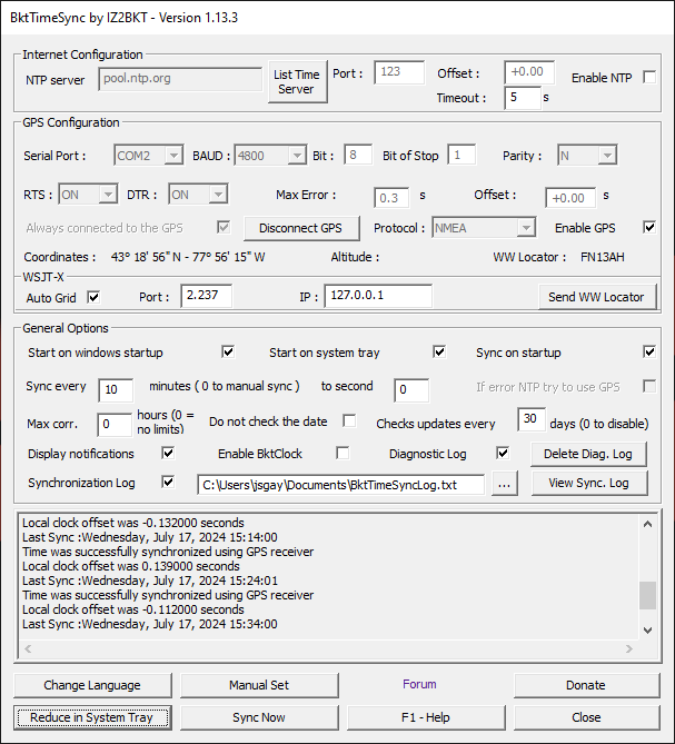

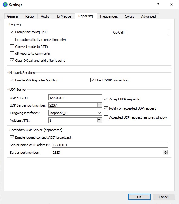

I have tried to get the Auto Grid to work with no results. I have followed the directions from this post: https://www.maniaradio.it/forum/showthread.php?tid=569
1. I am running Windows 10 with the latest updates
2. I have installed .Net Framework 4.8.1
3. I have made sure the IP address and ports are correct in both BktTimeSynce and WSJTX along with the check boxes for auto grid
4. I have made sure that I have the GPS info including grid square before trying to push the auto
See attached pictures and the diagnostic log.
[attachment=47]
[attachment=46][attachment=48][attachment=49]
