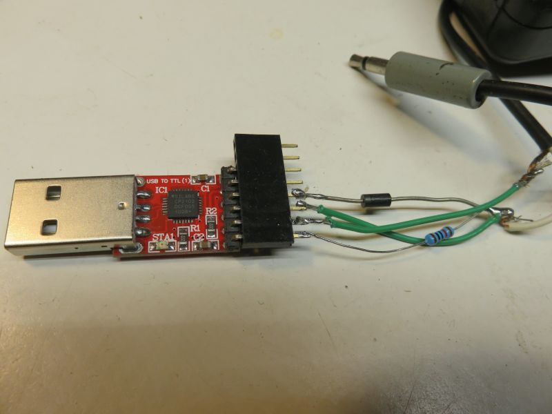

You can add this to the list of home made Icom CI-V cables .
I just made this one and it worked. I used a different kind of $2 usb to ttl board because I had one ( silicon labs CP210x is what it says )

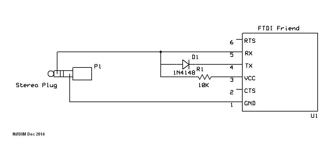

Here is schematic - only need a resistor and diode.
