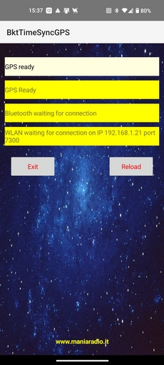

1. Start the App on the Smartphone: Open the BktTimeSyncGPS application on the Android smartphone. Ensure it is waiting for Bluetooth and/or WLAN reception.

  • Open the BktTimeSyncGPS app on the smartphone and note the IP address displayed in the WLAN section (e.g., "WLAN IP Address: 192.168.1.XXX").
  • Enter this IP address into the corresponding field within the PC software.
